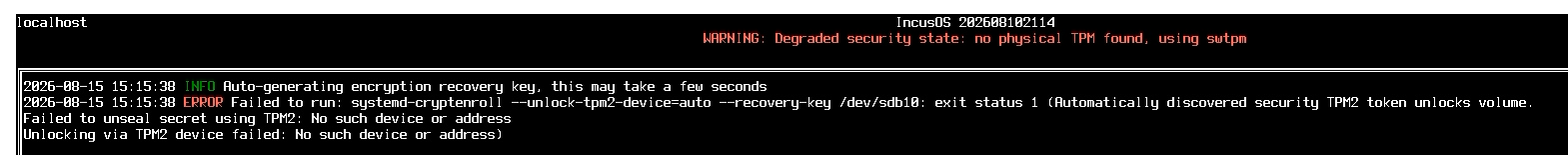

I’m trying to install IncusOS on the same machine I’d tried to get IncusOS running last December. The system boots, but it goes into a loop showing an error
ERROR Failed to run: systemd-cryptenroll --unlock-tpm2-device-auto --recovery-key /dev/sdb10: exit status 1 (Automatically discovered security  TPM2 token unlocks volume.)
In the image customizer, I had selected USB type, Operation usage, stable channel, pasted in my client cert, and no TPM 2.0 module. In my system firmware setup, I enabled secure boot and set the TPM device to “hidden.” I downloaded IncusOS_202608102114.img and flashed it to a 256 GB microSD card in a USB 3.0 reader. During boot, IncusOS displays a message about falling back to swtpm, as expected. IncusOS had rebooted once on its own before getting to this state.
Is there an issue with swtpm and cryptenroll, or is it just not possible to run IncusOS on this admittedly outdated hardware?

I tried again with a fresh download of IncusOS_202608290126. Unfortunately, with this old machine, I still get the same “automatically discovered security TPM2 token unlocks volume” error. It does say across the top of the screen that it’s using swtpm.

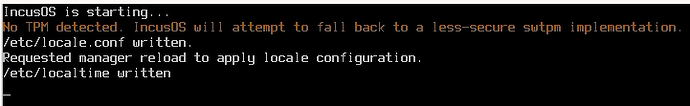

@johnp789 when your IncusOS system starts up, do you see the message No TPM detected. IncusOS will attempt to fall back to a a less-secure swtpm implementation. right after IncusOS is starting... ? If you do, then I think something’s going wrong with swtpm initialization; if you don’t, then there’s an issue with your system not fully hiding the physical TPM, which then results in two different TPMs being available and systemd-cryptenroll is getting confused.

I do see the message about attempting to fall back.

On this latest IncusOS reinstall (live USB boot, actually), I saw the error for /dev/sdb10 again. I haven’t noticed if a different partition is ever reported with an error, unfortunately.

I’ve managed to get the same failure as you reported by attempting to run IncusOS on a VM with extremely limited RAM resulting in the swtpm service failing in the initrd. When swtpm then starts up post-initrd, the TPM state is incorrect and therefore fails to properly setup disk encryption. (The error “No such device or address” turned out to be quite misleading, as the TPM itself exists and works; it’s the PCR policy embedded into IncusOS that doesn’t properly match and fails.)
I think what may be happening for you is that systemd-repart is either failing or not completing before the initrd exits. In my case, with the busted swtpm, systemd-repart also failed in the initrd, but then launched once the system was running. IncusOS also started, but exited with an error about the swap partition not existing. The incus-osd service then auto-restarted after a brief delay, during which time systemd-repart completed, and so on the “second” first start IncusOS found the expected partitions but now with a bogus TPM state hit the same error you’re seeing.

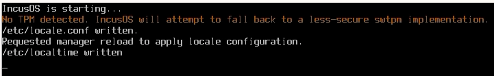

Well, I tried again with IncusOS_202609271243 on the HP t630, selecting operational-usage USB with no TPM 2.0 module. In the system firmware, I set the TPM to “hidden” and secure boot to enabled and “erase keys.” IncusOS boots once to tell me it is enrolling its secure boot keys, but when it reboots, it tells me “IncusOS cannot boot if SecureBoot is disabled and no physical TPM is present.” Sure enough, if I reboot from there into the firmware interface, I find that secure boot is disabled. I set secure boot to enabled but I don’t choose “erase keys.”
The t630 booted, and IncusOS starts, but stops at the “No TPM detected. IncusOS will attempt to fall back to a less-secure swtpm implementation” message for several minutes. Finally, I got the “IncusOS failed to start” message with debug info shown. The failed service was systemd-cryptsetup@root.service.
