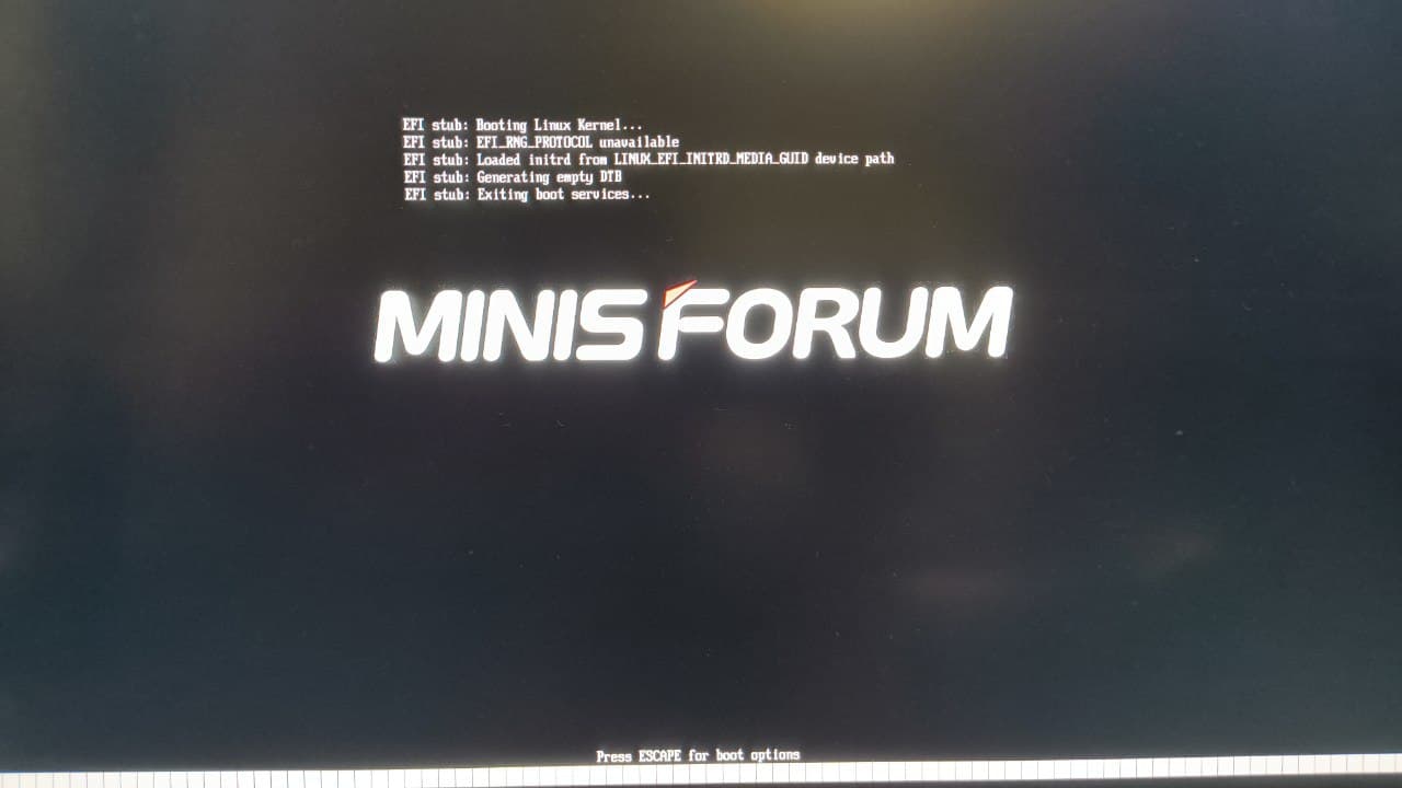

  1. Host HDMI/display freezes at BIOS message after booting the Zabbly kernel
  • After switching to the Zabbly kernel, the host’s screen stops updating just after the BIOS splash. The system boots fine (I can SSH in), but the HDMI display remains frozen on the initial BIOS/firmware screen. I don’t know which driver or kernel option to change to restore console output.

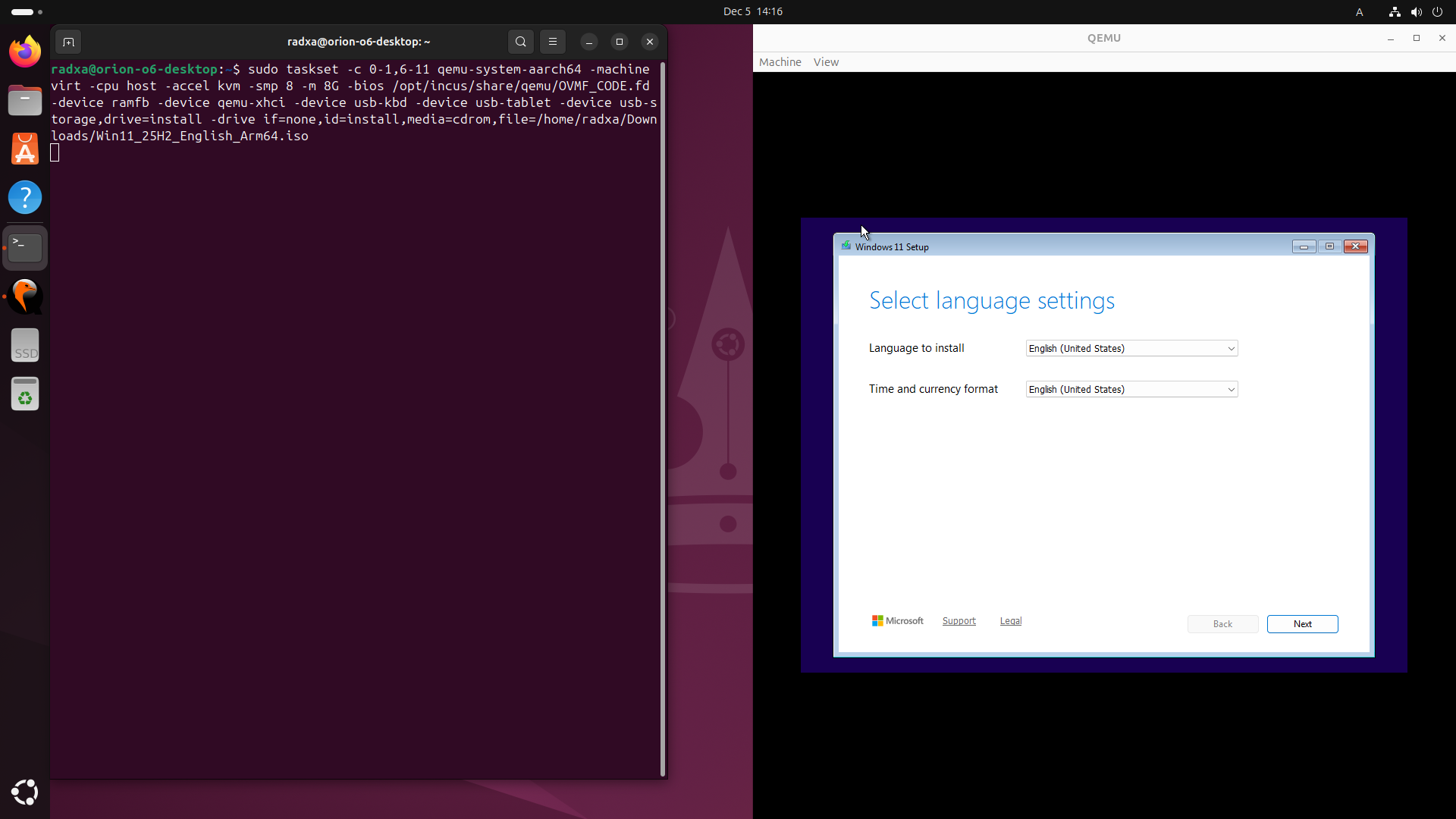

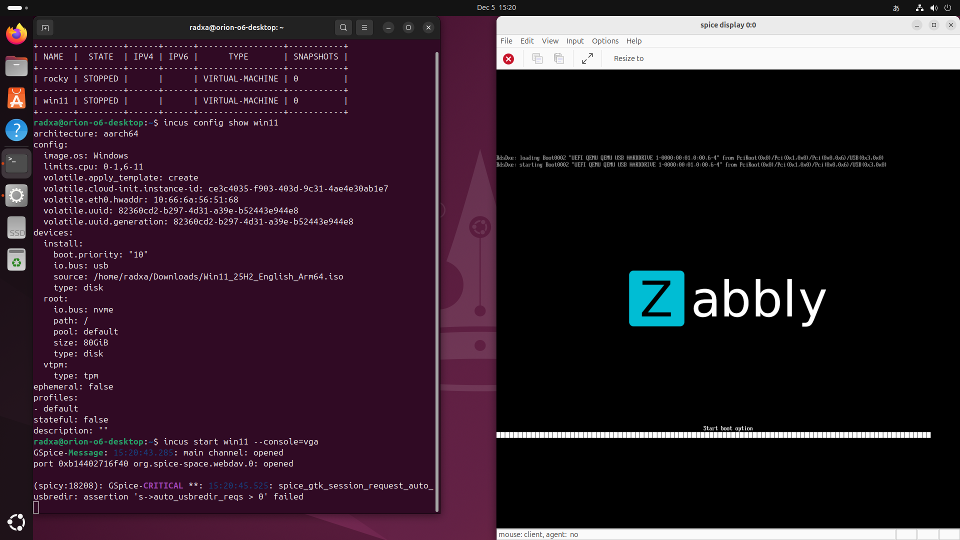

  1. Windows 11 ARM64 VM hangs at VM BIOS/firmware screen
  • I tried creating a Windows 11 ARM64 VM in Incus using the same approach I use for x86_64. The VM starts but hangs at the BIOS/UEFI screen. I’m not sure if I’m missing an aarch64 UEFI firmware, a qemu option, or a machine/cpu setting.

  2. For the VM BIOS hang: which aarch64 UEFI/QEMU firmware should I install and how should I configure Incus so the VM uses it? Are there special machine/cpu options I should set for a Windows 11 ARM64 VM under Incus?

This is how far my screen gets:

I don’t see anything in dmesg that indicates the iGPU is being found. What is the output from ls -la /sys/class/drm?
here:
# ls -la /sys/class/drm
total 0
drwxr-xr-x  2 root root    0 Dec  1 04:36 .
drwxr-xr-x 79 root root    0 Dec  1 00:51 ..
-r--r--r--  1 root root 4096 Dec  1 04:36 version
# cat /sys/class/drm/version
drm 1.1.0 20060810
Yea, that means the kernel isn’t finding the Mali G720.
More reading suggests to me that there are ongoing efforts to get hardware support upstreamed for these CIX SoCs. It sounds like ACPI support will come last, which is how your current Ubuntu install is working. More details here.
Also, here is a thorough MS-R1 review from someone else that covers the lack of hardware support in more “generic” kernels or ACPI installs. They talk about an official Debian 12 image (CIX Edition) with the required customizations to get all the hardware working. If the machine didn’t come with a copy of this Debian 12 image in some form I would contact Minisforum and ask for a download and try it out with a spare M.2 if you don’t want to lose the current installation.
Other than using the custom Debian 12 image it appears it is a waiting game for all the hardware support to go through the upstream process.

I’m encountering an issue while trying to boot a Windows 11 25H2 for Arm64 ISO as a VM on Incus. It is not booting.
Host: Radxa Orion O6
CPU: CIX P1 CD8180 (Only 8 A720 cores are used)
OS: Ubuntu Desktop 24.04.3
Kernel: 6.14.0-36-generic #36~24.04.1-Ubuntu
Incus: 6.19.1 (from Zabbly)
For reference, a Linux VM is working: I successfully installed Rocky Linux 10.1 from an ISO.
The Windows 11 ISO boots fine when run directly on QEMU 8.2.2 (from Ubuntu), but fails to boot (stuck at UEFI) when run via Incus.
Please disregard the current incompleteness of the command lines/configs. My sole objective is to successfully boot the Windows 11 ISO in the Incus VM. And I’m not dealing with iGPU/dGPU at this stage.
That’s identical to what I’m seeing with Windows 11 arm64 on Incus. I’m still looking for a solution.
I have identically experience trying to boot windows with incus on arm64. I could not get it to boot.
You could try setting:
  raw.qemu: -device usb-kbd
  raw.qemu.conf: |-
    [device "qemu_gpu"]
    addr=
    bus=
    driver=ramfb
That would add the USB keyboard (to workaround the current issue with the virtio keyboard) and would substitute virtio-gpu for ramfb.
Though in my tests, while I can now see the CDROM prompt and have it boot from there, I’m still not presented with the installer, so there may be more to this.
Adding raw.qemu: -device usb-kbd resolves the boot menu not responding to keyboard input.
Now I can see the installer, but the mouse is not visible in the installer, I need to navigate with keyboard.
Adding -device usb-tablet should be fine to take care of that
