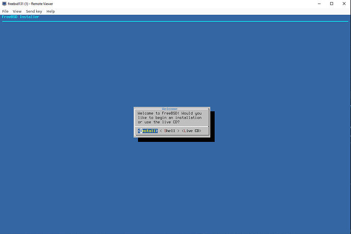

You’ll need virt-viewer installed to be able to see the installer. After you have that installed, you can proceed as follows:
lxc start freebsd131
lxc console freebsd131 --type=vga &
Install as usual and when you reboot the system, it’ll boot back to the installer. You’ll need to stop the VM and then remove the installer disk from the VM:
