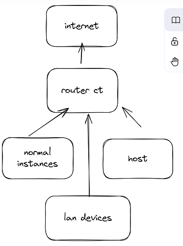

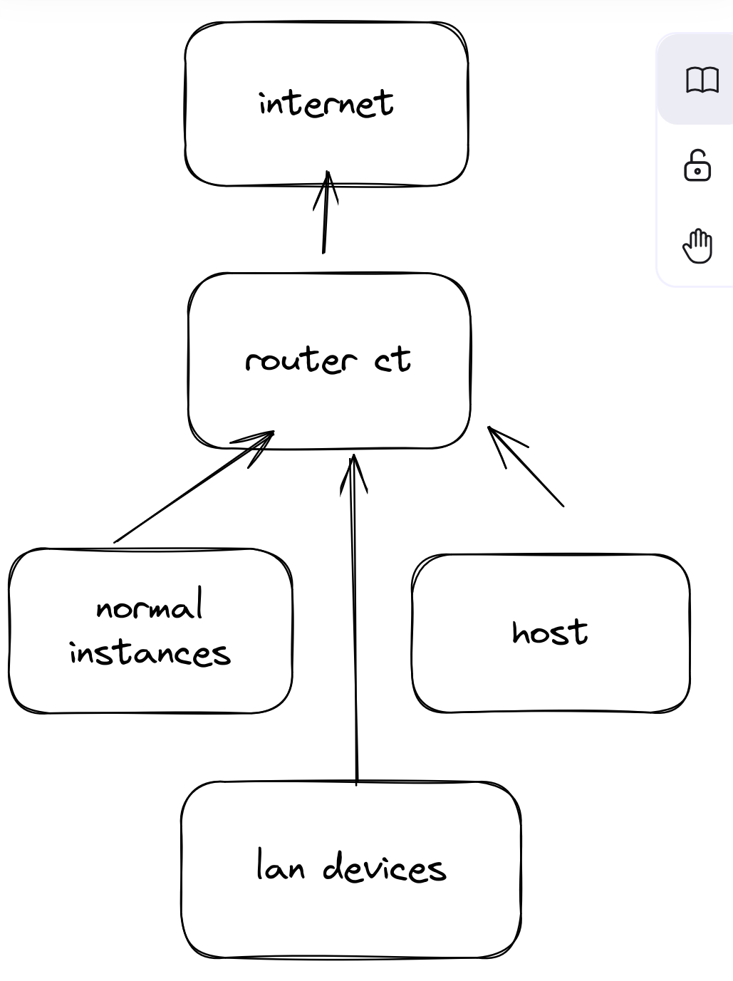

Hi, it’s me again.

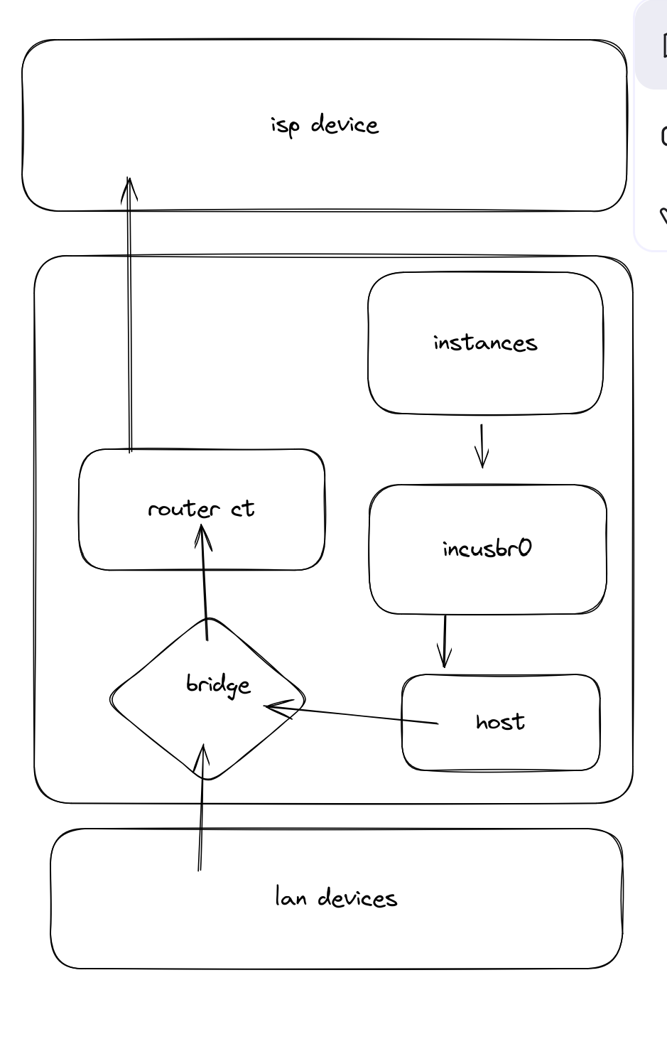

If I understand correctly, you want router container to be your home router for manage all network, like this:
I haven’t done it yet, but I’ve though about it. You only need 1 bridge for this. Passthrough a port to router container as wan port, and attach bridge to it as lan port. About this bridge, if you use linux bridge, you need to point ip in router ct lan range, and assign the other port to it, but if you use ovs bridge, you only need to assign port to it, ovs bridge doesn’t need ip. Now, no physic port for host to connect to network, to solve it, use bridge to create a virtual port, then host use this port to connect to network. About incusbr0, no need to config it, it will use host network. About lan devices, they will communicate with the port assigned to bridge, because the bridge will act as a switch, so need to config them too.
Cool, I recognized the username.
Yes, the diagram above is what I want.

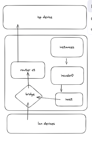

Ok, I think I understand.
  1. incusbr0 will be managed by host so that it can talk with containers, don’t mess with this
  2. create a bridge - either Linux or OVS and that is how the host will get to the Internet
Since I want the host to be on the same subnet as the LAN, then I’d want to create a Linux bridge.
I’ll report back once I figure that out :).

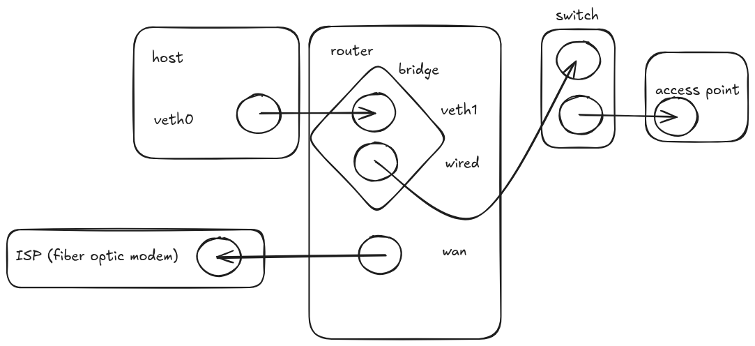

Let me try to draw this in ascii:
router container:
  • wan: DHCP
  • wired: static IP, set via OS networking conf
  • veth1: pair interface corresponding to veth0, assigned to container
  • gateway: bridge
    • veth1
    • wired
host (workstation):
  • veth0: originally assigned a static IP, but moved to DHCP so that the route and DNS would be updated (in theory)
  • incusbr0 and vethxxx were deleted as I could not find any references in my router container referring to them (other than backup.yaml)
I think the gateway (bridge) works as my DHCP request from veth0 gets to veth1 which I think see on wired. I just don’t see a response to the DHCP request for whatever reason.

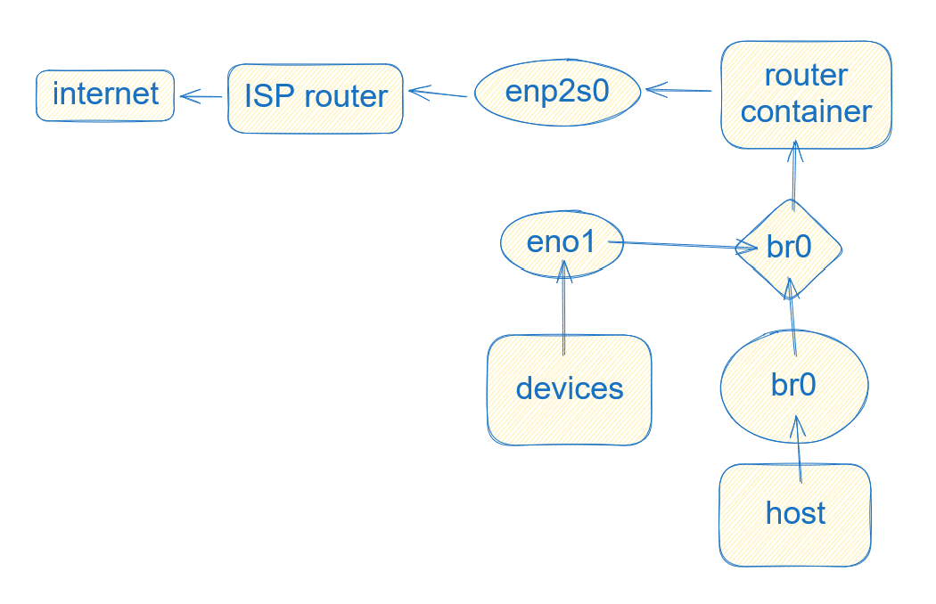

It’s so hard to understand what you wrote. Can you use excalidraw.com to draw you network topology next time?
Anyway you didn’t delete the virtual port as I told you to, is it veth0? That 's why your bridge failed. Host will use the same name as bridge to connect to network, is it gateway?
Here is the right one. Rectangle is device, ellipse is NIC, diamond is bridge. arrow point from lan port to wan port.
Here is my network:
I followed your schema, but put attempted to visually group devices how I think they are.
  1. bridge contains veth1 and wired ports
  2. host has a single veth0 port
  3. router has wired, wan, veth1, and bridge
I presently have the machine disconnected so I can post this; however.
  1. The host has an empty routing table, if it were able to get a DHCP lease, I would expect it to then have a proper routing table
  2. When the machine is connected, the router container has a routing table where it is routing traffic through the public IP on the wan port.
The incus created interfaces are no longer there as they were by default, but I think that is normally only needed for the default out of the box configuration from which I am clearly deviating.
OK, I understand now.
I’ve told you twice, host need to use the NIC same name as bridge to connect to network. So delete veth0 and veth1. Give bridge ip by DHCP or static. Test bridge, and it will work.
I have done something similar before. This post describes my solution. Might help: https://discuss.linuxcontainers.org/t/issue-rebooting-container-with-physical-nic-device-passthrough
Because linux bridge will create a hidden port same name as the bridge. When bridge NIC get an ip, it’s host using it not the bridgge.

  • Is this an acceptable practice to help make the results of these conversations more accessible in the future?
As part of my “incus everywhere” approach, I very much plan to execute a version of this in my local offices. I will keep everyone posted as I progress.
Container-Based Router Setup Guide
Core Concept
This guide describes how to create a home network setup where:
  1. A single physical host (workstation) has two NICs
  2. A container called “router” running inside this host functions as the router/firewall for the entire home network
  3. The physical NICs are passed through to the router container
  4. The host itself connects to the network through this container
This approach allows you to use one machine as both your workstation and router/firewall, saving power and hardware costs.
Network Architecture
This setup requires:
  1. One NIC (wan) connects to the ISP/upstream router
  2. Another NIC (wired) connects to the local network devices
  3. The router container manages all traffic and provides DHCP, DNS, etc.
  4. The host itself connects to the router container through a bridge interface
Network Diagram
│   Internet  │◄────────►│ ISP Router  │◄────────►│    WAN      │
│             │          │             │          │    (enp2s0) │
                                                  │  Container  │
                                                  │  "router"   │
│ LAN Devices │◄────────►│    LAN      │◄────────►│   Bridge    │
│             │          │   (eno1)    │          │  (gateway)  │
                                                  │    Host     │
                                                  │ Workstation │
Detailed Implementation Guide
1. Physical Setup
  • Host Hardware: A desktop computer with two physical NICs
    • NIC 1 (enp2s0): Will be passed through to container as WAN interface
    • NIC 2 (eno1): Will be passed through to container as wired/LAN interface
  • Software: Incus (container manager), bridge-utils
2. Creating the Router Container
# Create the router container
incus launch <image> router
# Pass the WAN NIC to the container
incus config device add router wan nic nictype=physical parent=enp2s0 name=wan
# Pass the LAN NIC to the container
incus config device add router wired nic nictype=physical parent=eno1 name=wired
3. Host Network Configuration
Creating a bridge on the host provides the connection point between the host and the router container:
# Install bridge utilities if not already present
apt install bridge-utils  # (or equivalent for your distro)
# Create a bridge
brctl addbr gateway
# Bring the bridge up
ip link set gateway up
# Assign IP to the bridge (in the LAN subnet)
ip addr add 192.168.1.180/24 dev gateway
4. Container Network Configuration
Inside the router container:
# Configure the WAN interface (either DHCP or static)
# For DHCP:
dhclient wan
# Configure the LAN interface with a static IP
ip addr add 192.168.1.1/24 dev wired
# Create a bridge and add the LAN interface to it
brctl addbr gateway
brctl addif gateway wired
# Enable IP forwarding
sysctl -w net.ipv4.ip_forward=1
# Set up NAT (using iptables)
iptables -t nat -A POSTROUTING -o wan -j MASQUERADE
iptables -A FORWARD -i gateway -o wan -j ACCEPT
iptables -A FORWARD -i wan -o gateway -m state --state RELATED,ESTABLISHED -j ACCEPT
5. Setting Up DHCP and DNS on Router Container
# Install dnsmasq
apt install dnsmasq
# Configure dnsmasq to provide DHCP and DNS on the LAN
cat > /etc/dnsmasq.conf << EOF
interface=gateway
dhcp-range=192.168.1.50,192.168.1.150,24h
dhcp-option=option:router,192.168.1.1
dhcp-option=option:dns-server,192.168.1.1
EOF
# Restart dnsmasq
systemctl restart dnsmasq
6. Host Routing Configuration
Configure the host to use the router container as its gateway:
# Add default route via the bridge
ip route add default via 192.168.1.1 dev gateway
# Configure DNS to use the router container
echo "nameserver 192.168.1.1" > /etc/resolv.conf
7. Making Configuration Persistent
Create startup scripts to ensure all settings are applied after reboot:
  • For the host, add these configurations to network startup scripts (depending on distro)
  • For the container, create a startup script that applies all the network settings
Key Technical Insights
  1. The Bridge Interface: The Linux bridge creates a virtual switch. When you assign an IP to the bridge itself, the host can use it as a network interface.
  2. Physical NIC Passthrough: By passing physical NICs to the container, the container gets direct control of the hardware.
  3. Traffic Flow:
    • Internet → WAN NIC → Router Container → Bridge → LAN Devices/Host
    • Host → Bridge → Router Container → WAN NIC → Internet
  4. No Need for Veth Pairs: A common confusion is trying to use veth pairs when they aren’t necessary. The bridge itself provides the connection point between host and container.
Troubleshooting
Common Issues
  1. DHCP Not Working:
    • Ensure dnsmasq is properly configured and running
    • Check that the bridge interfaces are properly connected
    • Verify that firewall rules aren’t blocking DHCP requests
  2. Host Can’t Access Internet:
    • Verify IP forwarding is enabled in the container
    • Check that NAT is properly configured
    • Ensure the default route on the host points to the router container
  3. Container Networking Resets After Reboot:
    • Create proper startup scripts to configure networking
    • For Incus, use hooks to ensure network configuration applies at container start
  4. Bridge Issues:
    • Make sure physical interfaces are properly added to bridges
    • Check that bridges have the correct IP configurations
    • Verify that bridge interfaces are up and running
Benefits of This Setup
  1. Resource Efficiency: Uses a single physical machine for both routing and workstation tasks
  2. Isolation: Network services run in a container, isolating them from the host system
  3. Flexibility: Easy to modify network configuration without affecting the host
  4. Security: Provides an additional layer of isolation for network services
  5. Power Savings: No need for a separate dedicated router device
When I go do implement this for real, the host will be debian and the router container will be executed in nixos. Does anyone have an interest in working through this together?
