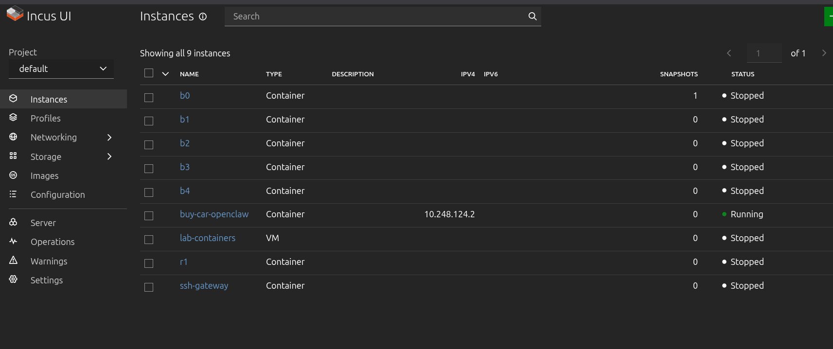

That wasn’t to bad. Unfortunately, now you’re going to run into a problem. The default authentication mechanism for the UI is client certificates and when you visit https://localhost:8443 for the first time, you’ll be prompted to create a new client certificate which you’ll then have to import into your browser. Unfortunately, importing PKCS12 certificates is broken in many current browsers and distributions. To get around that, head on over to Configure Incus UI with SSO to set up Google SSO. There’s another page which may be easier to follow at Setup oidc login · canonical/lxd-ui Wiki · GitHub that also describes how to set it up.
That should do it.

UPDATE: It looks like creating and importing client certificates is working now, at least on Chromium based browsers however if you still want to go the SSO route, there an easy tutorial for setting up SSO with a locally hosted keycloak server for LXD-UI. I just tried it and worked fine.
thanks for this, the solution was great for me! i ran keycloak locally under a podman systemd server and just followed the instructions in the guide you linked.
