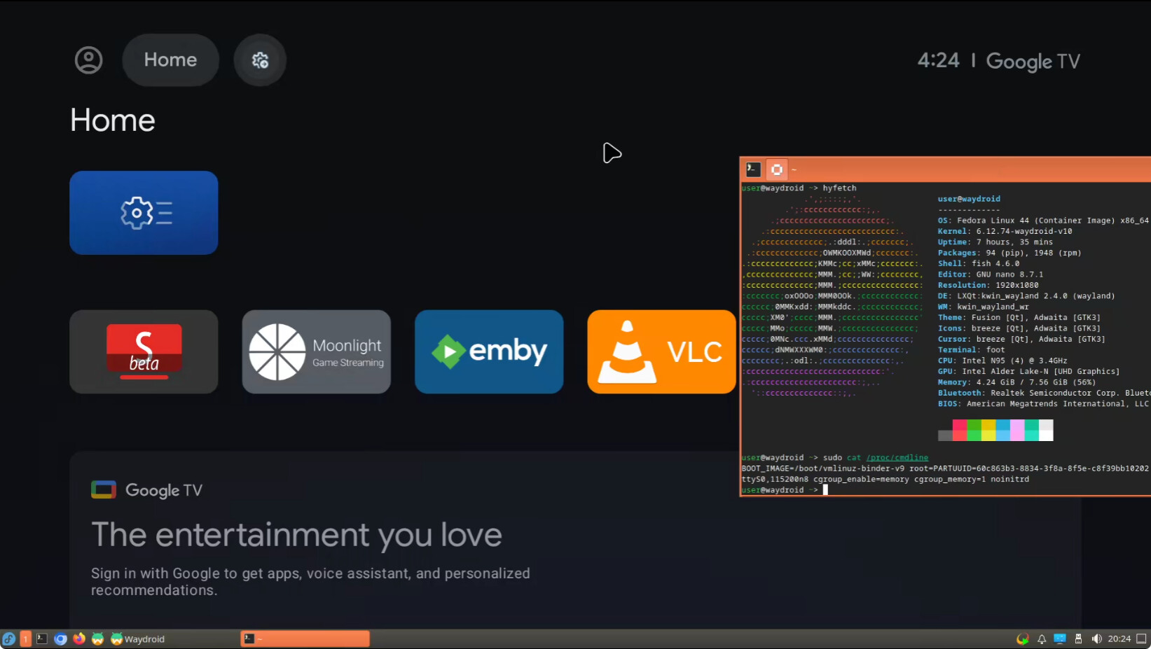

Now, is waydroid part. You should know the core of waydroid is waydroid’s LXC, which is a LXC container, so you don’t need to put waydroid in container. And I can firmly tell you only need LXC and binder and (memfd|ashmem) and psi=1 to start waydroid’s LXC.
Step 1
So, before you try, you need to know whether your kernel support binder.
For ubuntu:
grep -i -e android -e memfd -e ashmem "/boot/config-$(uname -r)"

From archwiki: The modules can either be compiled into the kernel (y), into modules (m), or not at all (n).
So for ubuntu, it has memfd compiled into the kernel and binder compiled into modules. For arch linux, it has memfd and binder compiled into the kernel. Debian’s binder is not at all, please tell me if you know how to compile binder into module.

Second part is run waydroid.
Make sure user has started wayland compositor and audio control service.
As root run below commands:
mkdir -p /dev/binderfs
modprobe binder_linux
mount -t binder binder /dev/binderfs
/var/lib/waydroid/binder.py
chmod 666 -R /dev/binderfs/anbox-binder
chmod 666 -R /dev/binderfs/anbox-vndbinder
chmod 666 -R /dev/binderfs/anbox-hwbinder
ln -s /dev/binderfs/anbox-hwbinder /dev/binderfs/anbox-vndbinder /dev/binderfs/anbox-binder /dev/binderfs/features /dev/binderfs/binder-control /dev/
chmod 777 -R /dev/dri/renderD128
chmod 777 -R /dev/fb0
chmod 777 -R /dev/dma_heap/system
mount -o ro /etc/waydroid-extra/images/system.img /var/lib/waydroid/rootfs
mount -t overlay -o ro,lowerdir=/var/lib/waydroid/overlay:/var/lib/waydroid/rootfs,upperdir=/var/lib/waydroid/overlay_rw/system,workdir=/var/lib/waydroid/overlay_work/system,xino=off overlay /var/lib/waydroid/rootfs
mount -o ro /etc/waydroid-extra/images/vendor.img /var/lib/waydroid/rootfs/vendor
mount -t overlay -o ro,lowerdir=/var/lib/waydroid/overlay/vendor:/var/lib/waydroid/rootfs/vendor,upperdir=/var/lib/waydroid/overlay_rw/vendor,workdir=/var/lib/waydroid/overlay_work/vendor,xino=off overlay /var/lib/waydroid/rootfs/vendor
mount -o bind /var/lib/waydroid/waydroid.prop /var/lib/waydroid/rootfs/vendor/waydroid.prop
lxc-start -P /var/lib/waydroid/lxc -n waydroid -- /init
Wait a few seconds, waydroid will show in your screen.
To verify the CT status: lxc-info -P /var/lib/waydroid/lxc -n waydroid -sH
To stop the CT with cli: lxc-stop -P /var/lib/waydroid/lxc -n waydroid -k

Solved waydroid won’t start in CT.
In host:
sudo modprobe ip_tables
sudo modprobe binder_linux
In CT:
Edit /usr/lib/waydroid/tools/helpers/drivers.py
Turn this fuction:
def probeAshmemDriver(args):
    if not os.path.exists("/dev/ashmem"):
        command = ["modprobe", "-q", "ashmem_linux"]
        tools.helpers.run.user(args, command, check=False)
        return -1
    return 0
into:
        return -1
Then as root:
waydroid init -f
cat >> /var/lib/waydroid/waydroid.cfg << EOF
ro.hardware.gralloc=default
ro.hardware.egl=swiftshader
EOF
waydroid upgrade -o
systemctl restart waydroid-container.service
Then as user:
waydroid
