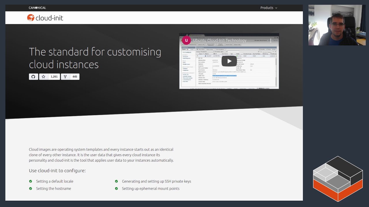

And @stgraber has also produced a video on using cloud-init with LXD.
