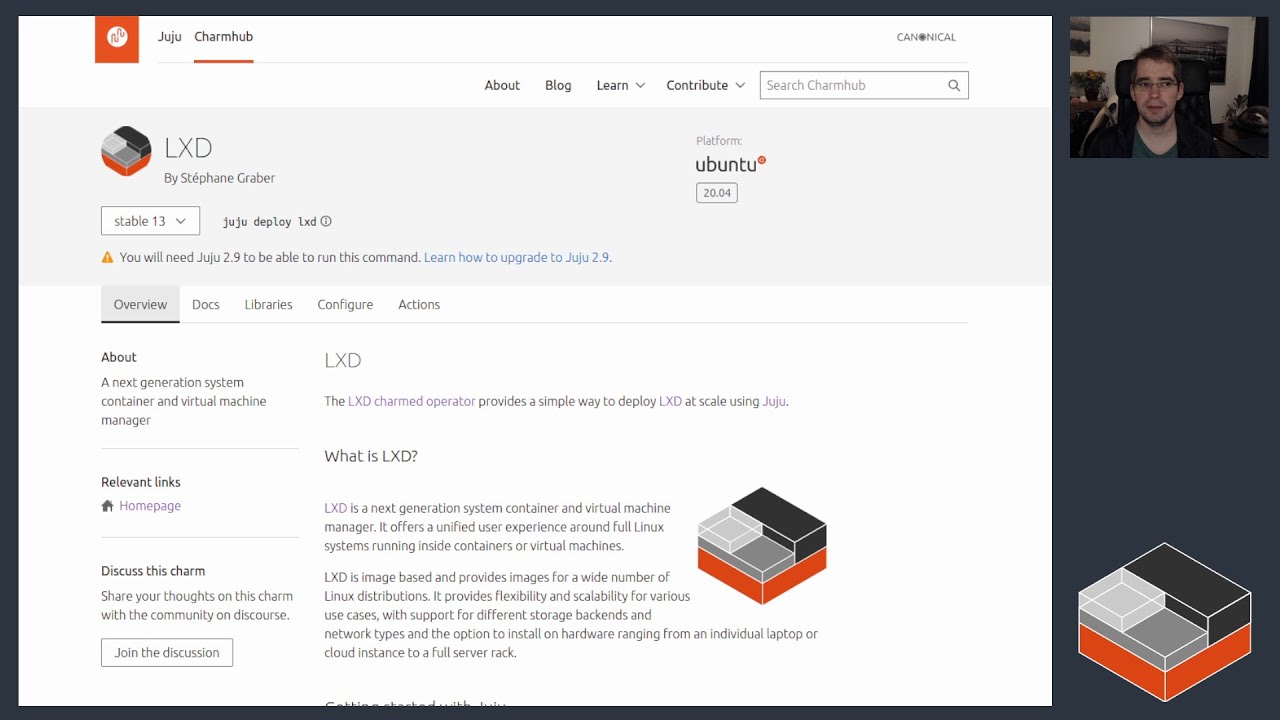

@stgraber has added a new video covering deployment of LXD clusters with Juju:
https://www.youtube.com/watch?v=JgNVAvcXR9Q
