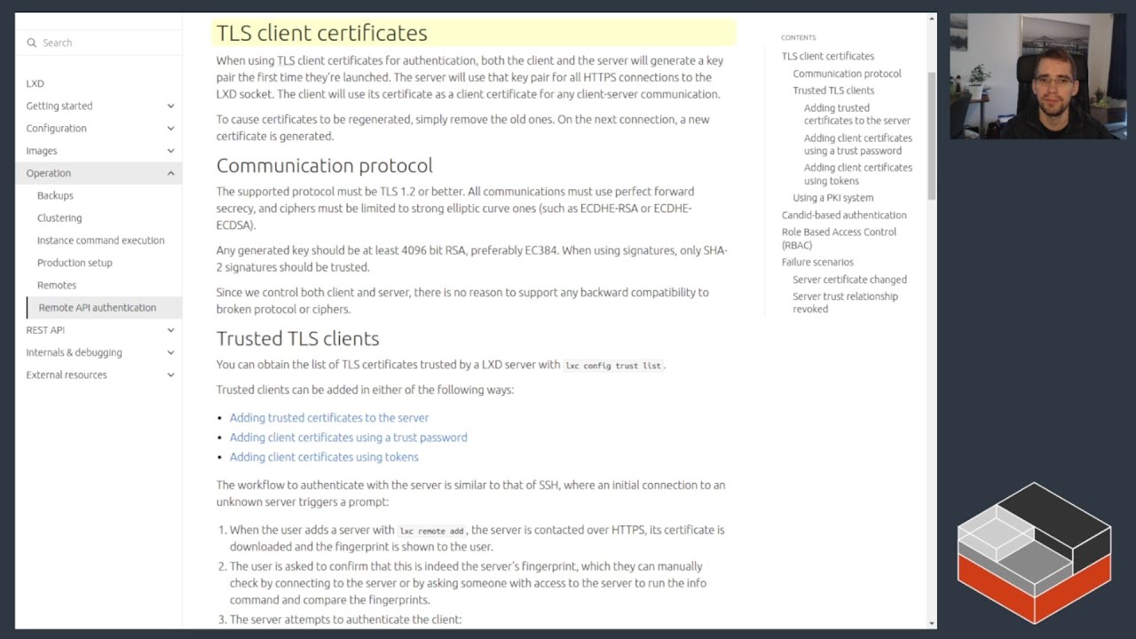

Additionally @stgraber has created a video on the new token based authentication for LXD remotes.
