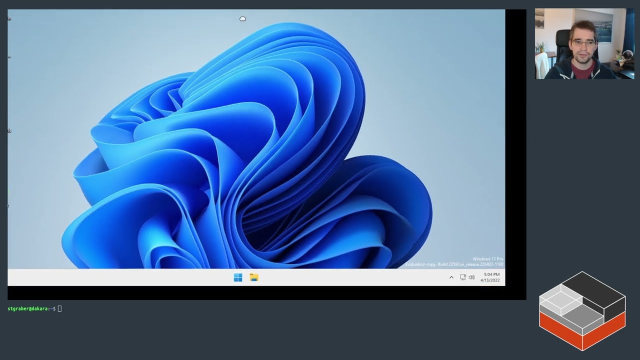

In addition to that, following on from the recent 5.0 LTS LXD release, @stgraber has added a video covering the key changes from the 4.0 LTS series for those planning the upgrade:
