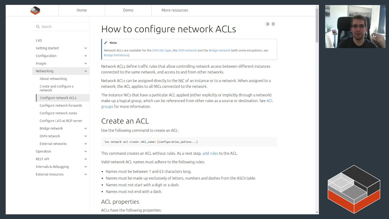

@stgraber has also added a video covering LXD’s network ACL (Access Control List) features:
