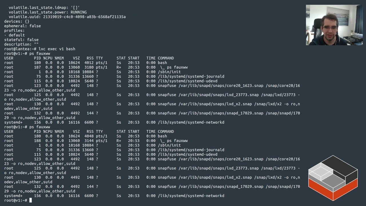

Additionally @stgraber has added a video covering migrating systems into LXD:
