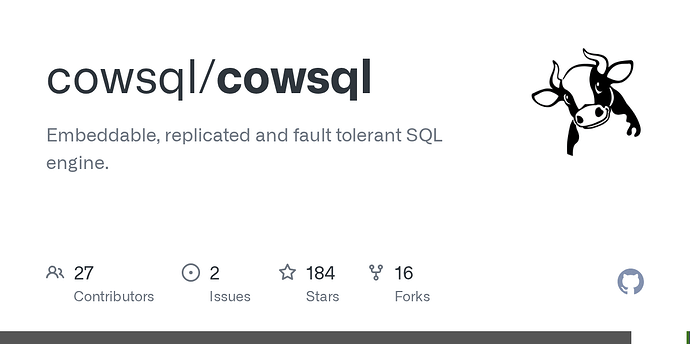

Transition to Cowsql
Shortly after @cyphar forked LXD as Incus, @freeekanayaka, the original author of Dqlite, also decided to fork Dqlite as Cowsql. Given that @freeekanayaka is also a maintainer on Incus, it made sense to port incus over to Cowsql.
Similarly to Incus itself, Cowsql is a community fork of Canonical Dqlite, largely compatible with Dqlite, allowing Incus to easily import existing data during the migration stage.
Focus on Cowsql so far has been on dramatically improving performance testing and making a number of changes across the Raft and Cowsql layers to make it as performant as possible for Incus’ usage pattern.

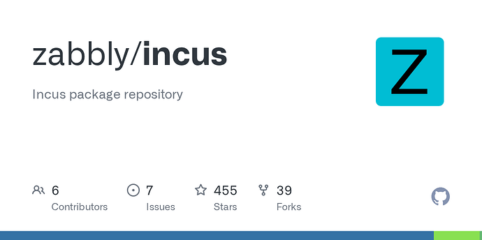

Zabbly packages for Debian and Ubuntu
Zabbly provides both daily and stable builds of Incus to Debian and Ubuntu users:
The client tool will soon be available through Chocolatey for Windows users.
Until then, binaries can be found here: Release Incus 0.1 · lxc/incus · GitHub

The Incus project itself doesn’t not produce packages, we leave that to community packagers and distributions to sort out as is customary with open source projects.
Currently the only packages we’re aware of are those that my company produces for Debian and Ubuntu users as well as the client-only packages for Windows and macOS.
There are a number of issues/package requests filed for a variety of distributions but it’s probably still a bit early to expect packages to be widely available.
A quick bit of Googling found an initial COPR repo for Incus on Fedora but packages aren’t yet available in it, so definitely looks like someone’s interested in getting that to work :slight_smile:
