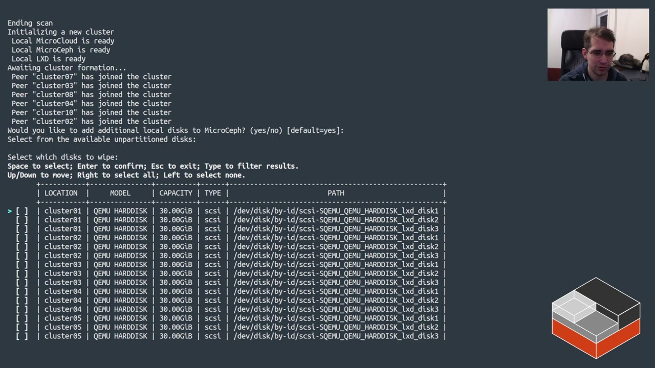

MicroCloud demo
Hot on the heels of the MicroCeph demo last week, this week @stgraber has made a video demonstrating the new MicroCloud package we have been working on.
The MicroCloud snap drives two other snaps (LXD and MicroCeph) enabling automated deployment of a highly available LXD cluster for compute with Ceph as a storage backend.
For networking, MicroCloud will use a default network bridge, but MicroOVN is in development and will be added once completed.
For more info see Introducing MicroCloud
