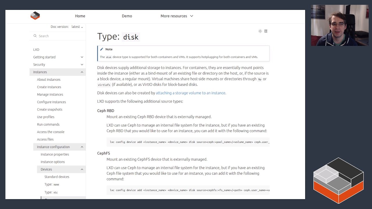

Additionally @stgraber has also started a new video series on LXD Instance Devices; the first of which is covering the disk device type:
