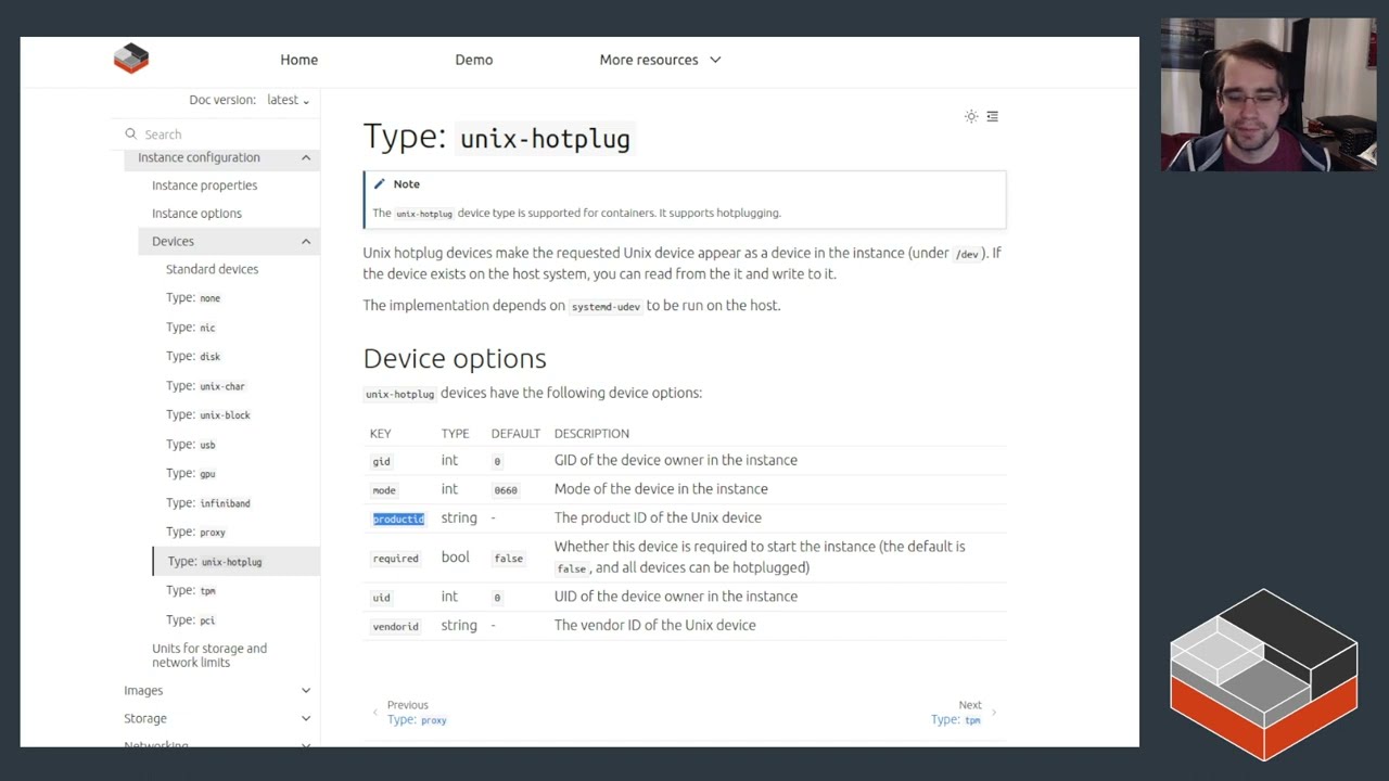

Additionally @stgraber has continued his series on LXD Instance Devices, this week covering the unix-char, unix-block and unix-hotplug device types .
